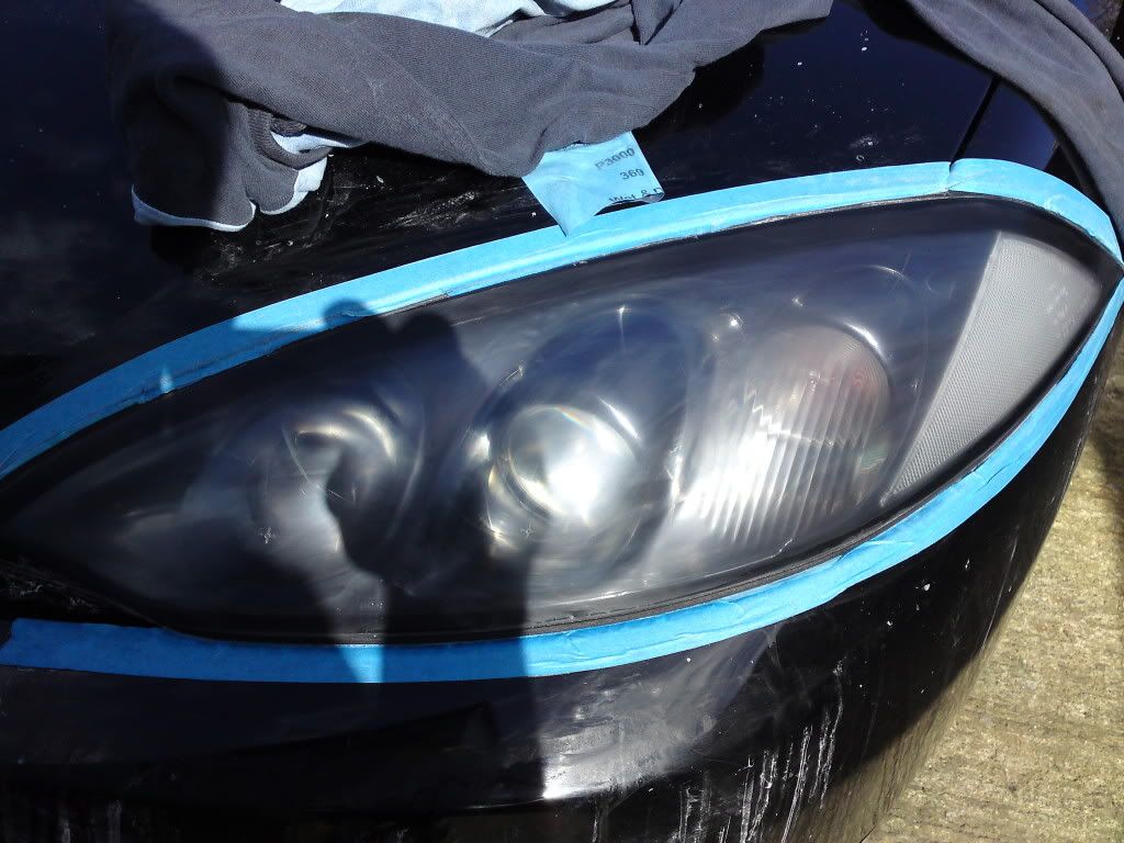

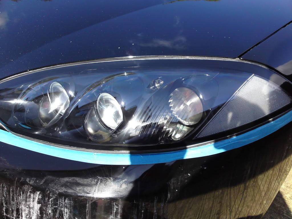

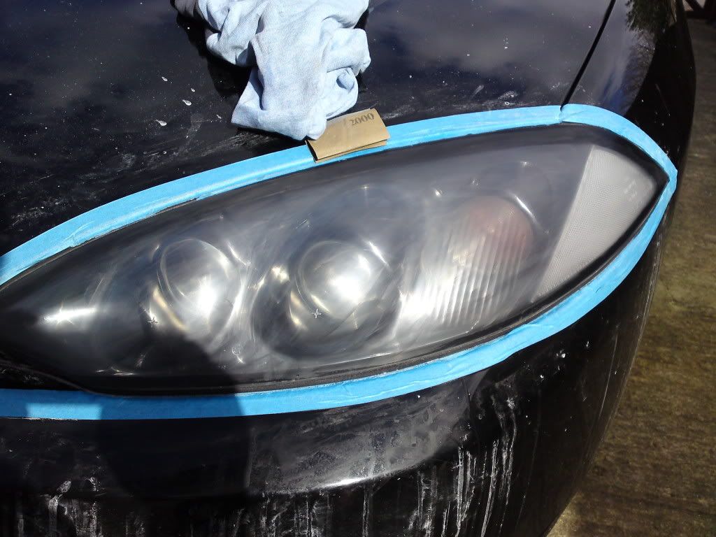

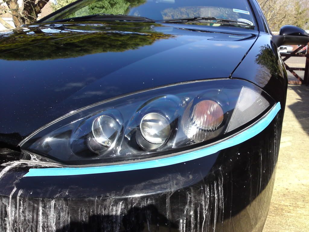

At last....sandpaper arrived which enabled me to finish the headlight. The end result isn't perfect as I need to purchase some smaller diameter cutting pads to help cut around the "boobies", but the finish is still a million times better than it was:
so.....2000 grit wet and dry:

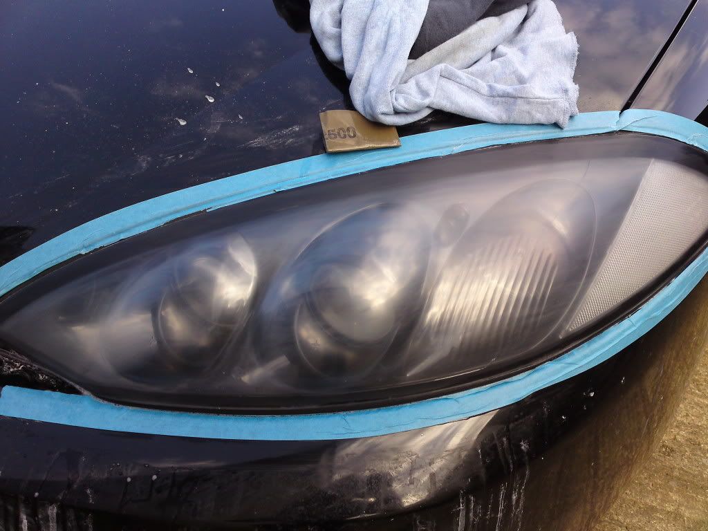

Then 2500 grit wet and dry:
Then 3000 grit wet and dry:

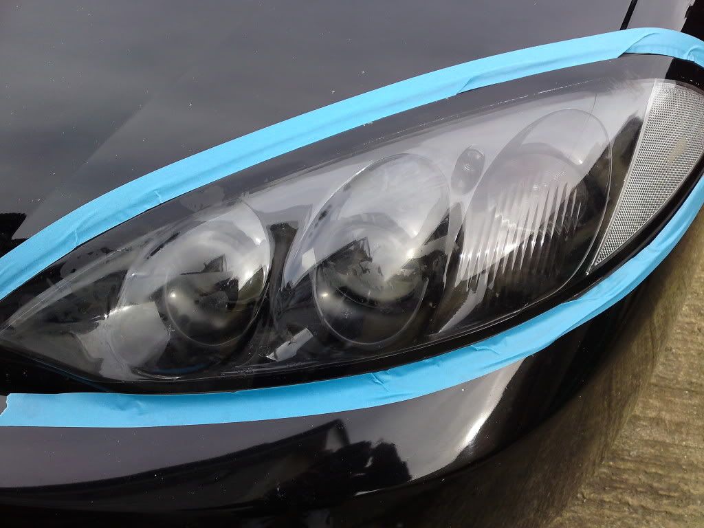

Finally Meguiars PlastX:

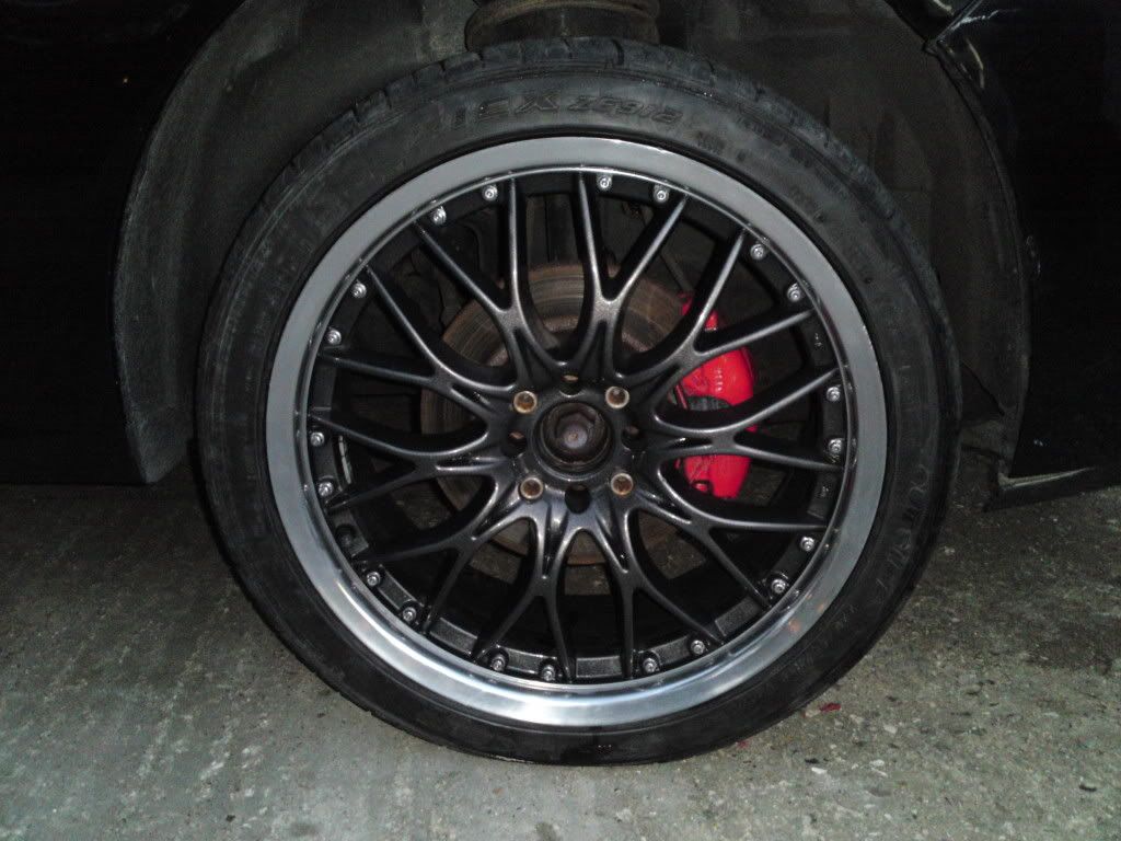

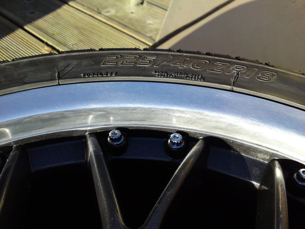

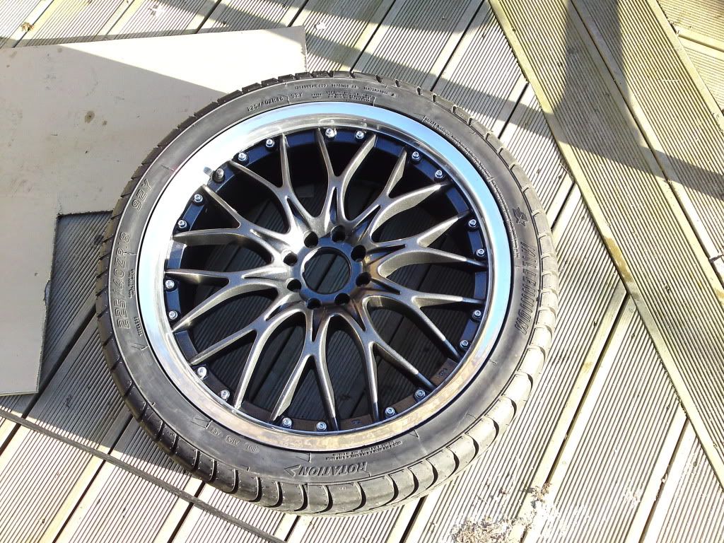

I then finished the wheels. I got fed up of sanding them down, so attached one wheel at a time, stuck the car in first gear, let the wheel spin while I held the wet and dry paper against it
Much easier!!
After sanding i then polished them up with a polishing attachment on my drill. Again, not 100% perfect mirror finish, but good enough for me and again, a million times better than before.

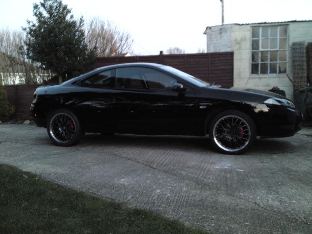

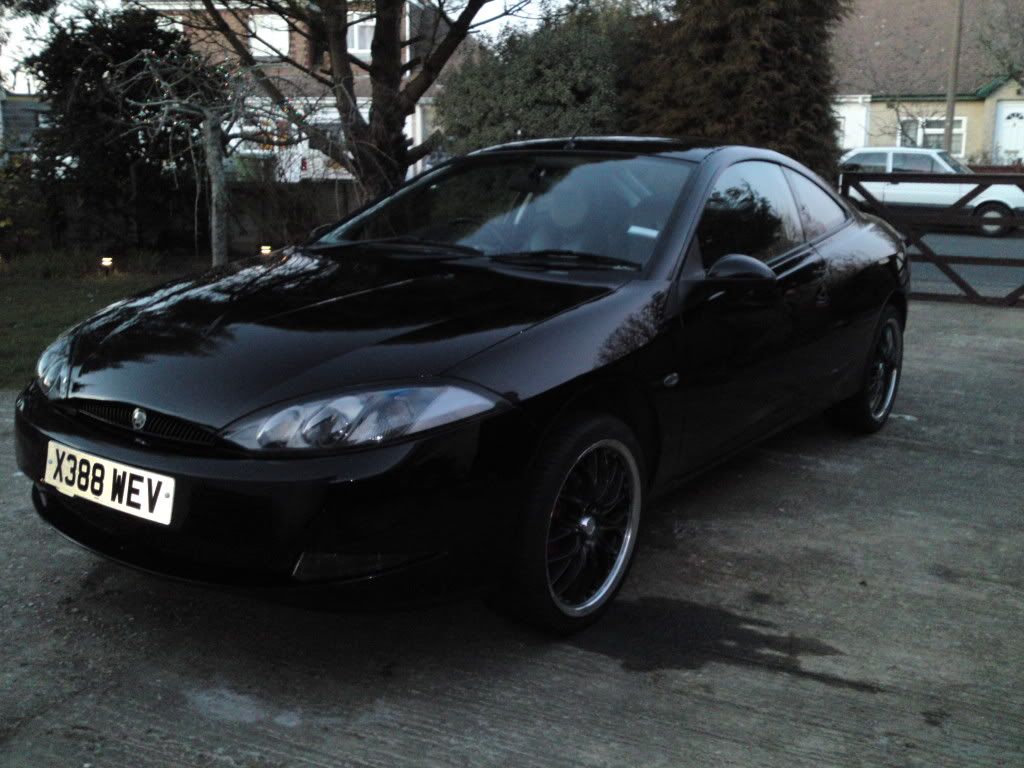

It was dark by the time I had finished so no very good pic. Also, car only just down from it's axel stands, hence the very OFF ROAD appearance. Notice I had also cut and polished the front bumper, removed the brick and attached the plate direct to the bumper for a much cleaner appearance:
Forgot I hadn't put the centre cap on when I took this piccie:
