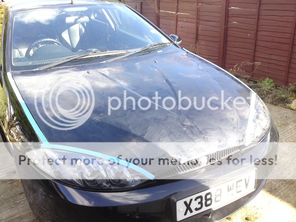

So...............the saga continues. Today, thank God, it decided not to rain.

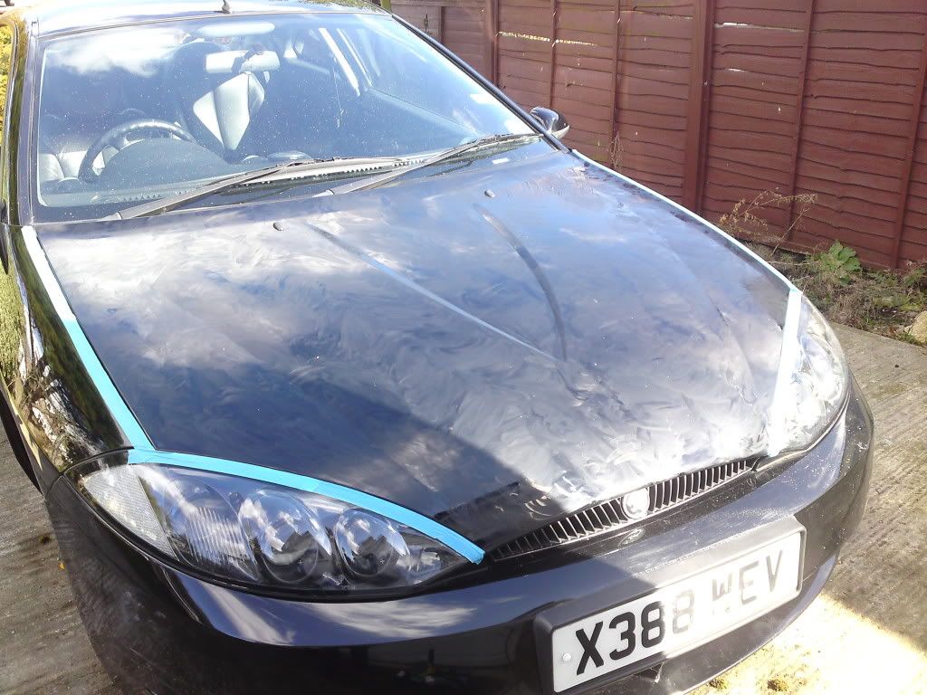

I therefore managed to finish the bonnet.
A couple of passes with Menzerna power Gloss on a heavy cutting pad, followed by a single pass of Menzerna Final finish on a finishing pad.
I then went over the whole bonnet with poor Boys Black Hole Sealer Glaze.
Finally I then applied DoDo Juice Purple Haze by massaging it onto the paintwork with my fingers:
The bonnet looks great but I will be honest and admit that in an ideal world, it would have a respray. Allthough my car has yet to hit 50k miles, the front of the car is soooooooo badly stone chipped I almost wanted to cry. The worst stone chips i will be sorting out later, but for the hundreds of tiny ones, there isn't anything left I can do.

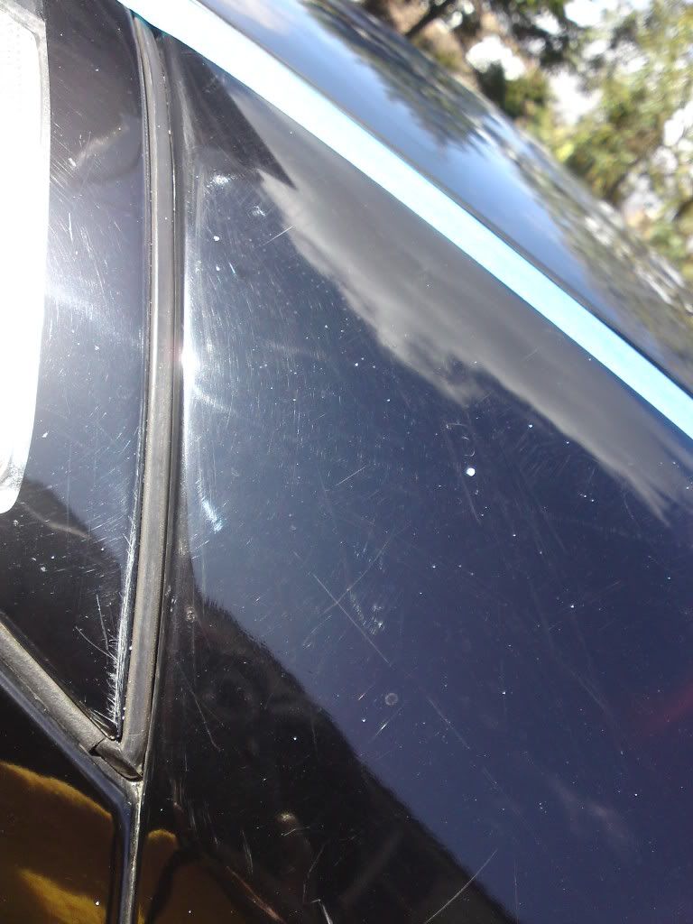

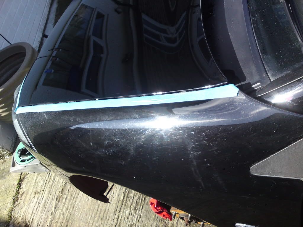

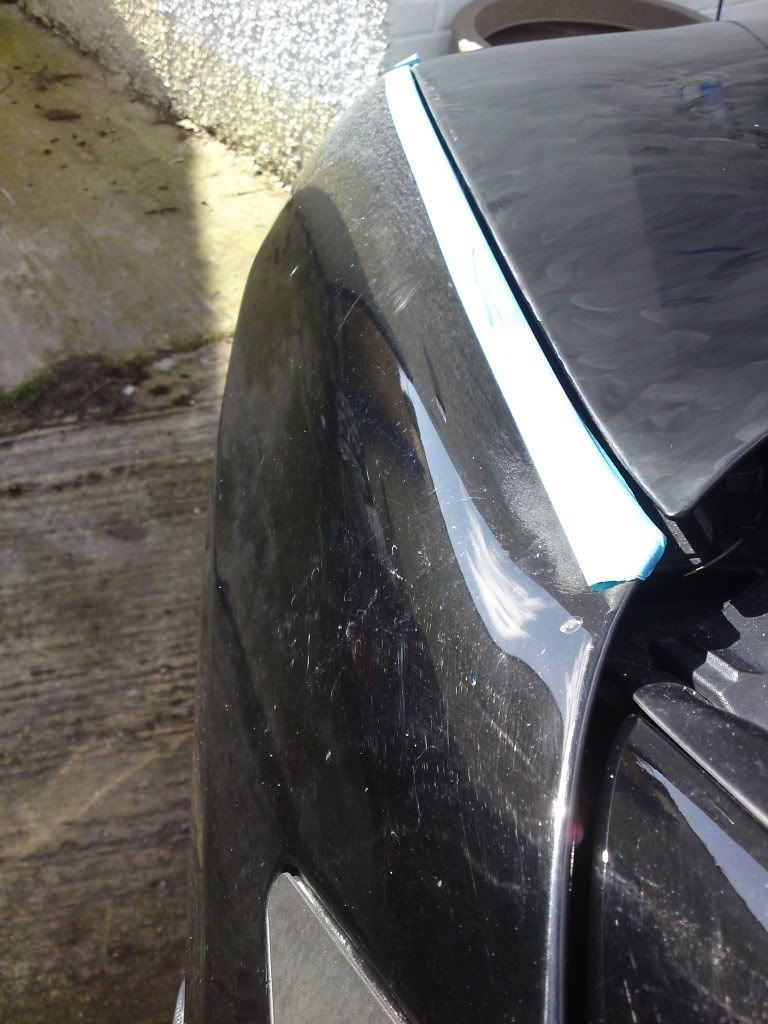

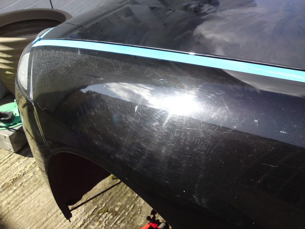

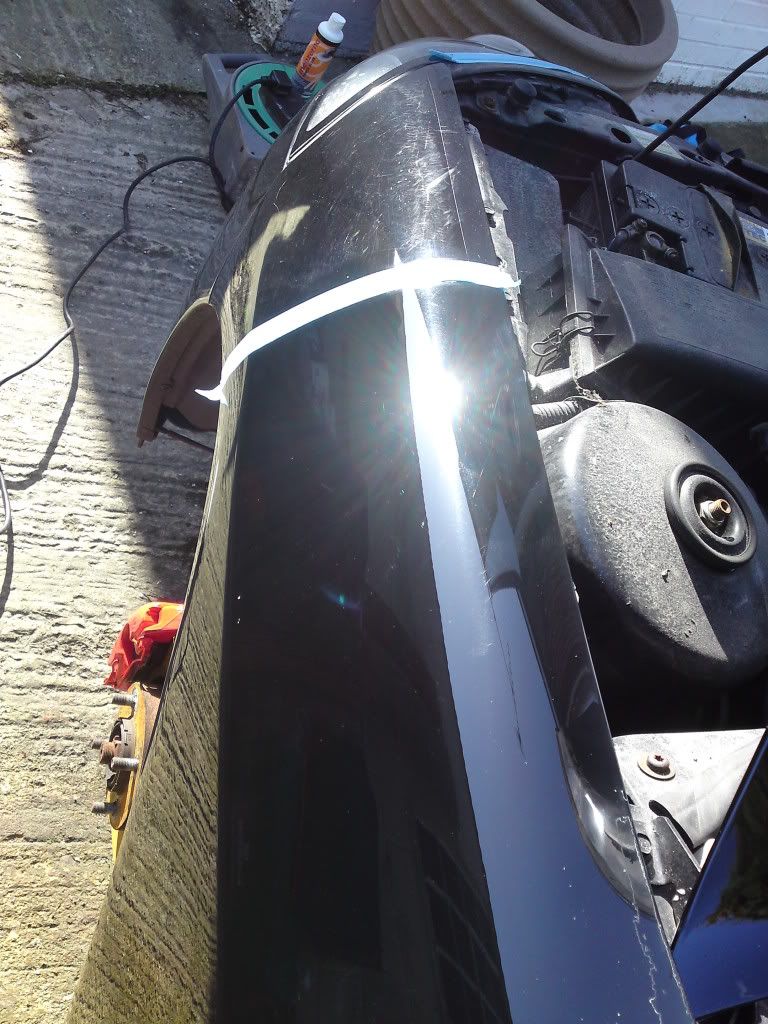

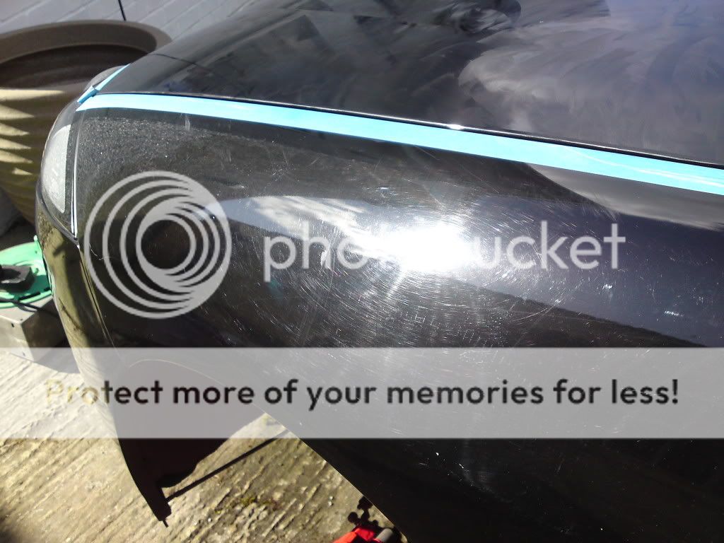

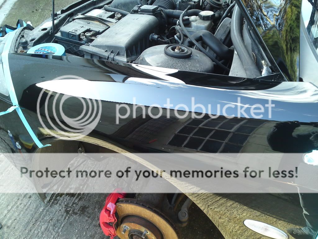

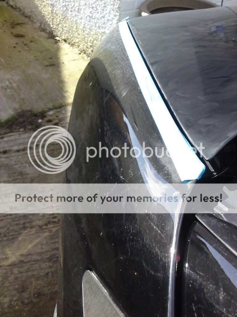

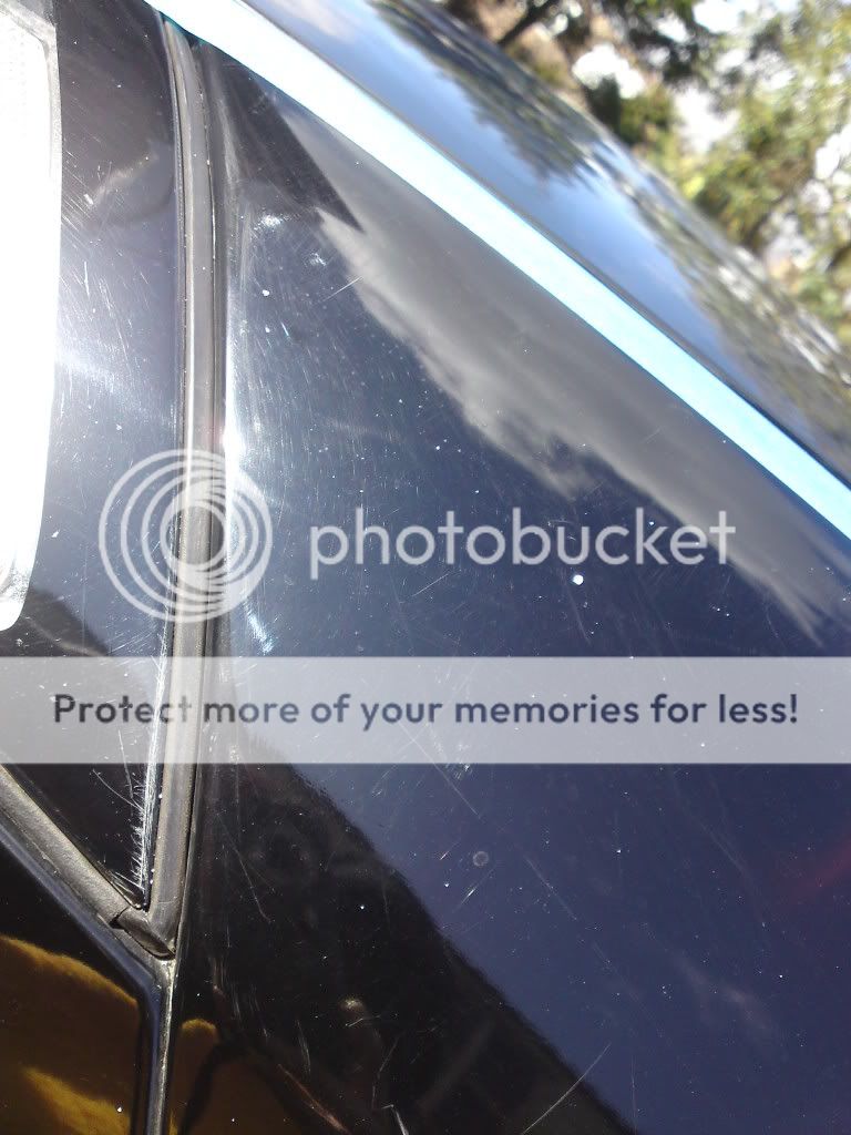

I then moved onto the passenger side wing. As you can see from these photos, the paintwork was awefull :yikes: How on earth it got to this state I will never know. BTW, you can see in one of the pictures that the passenger side headlight looks quite scratched. This will also be "attacked" and detailed on here, later next week.

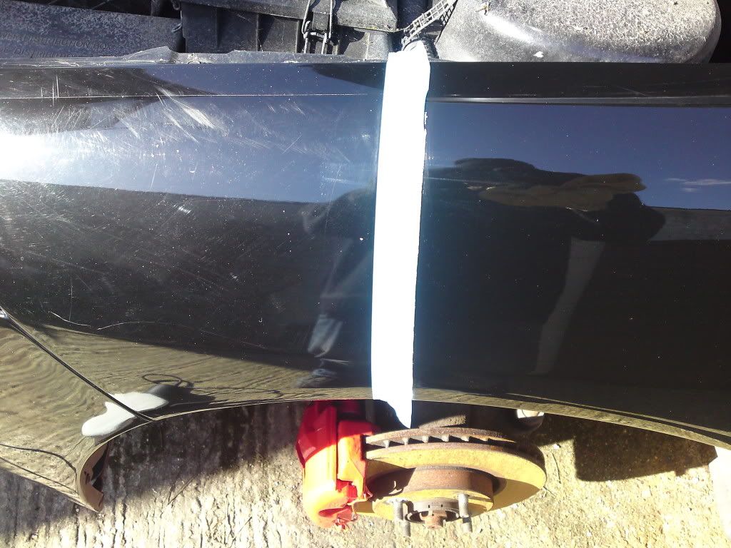

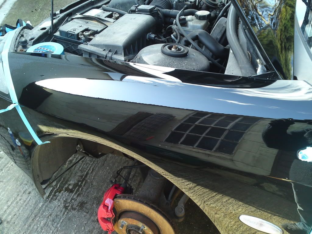

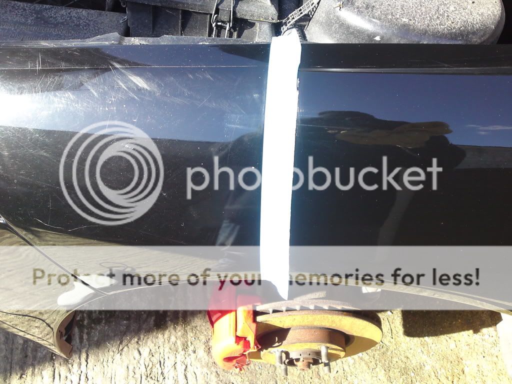

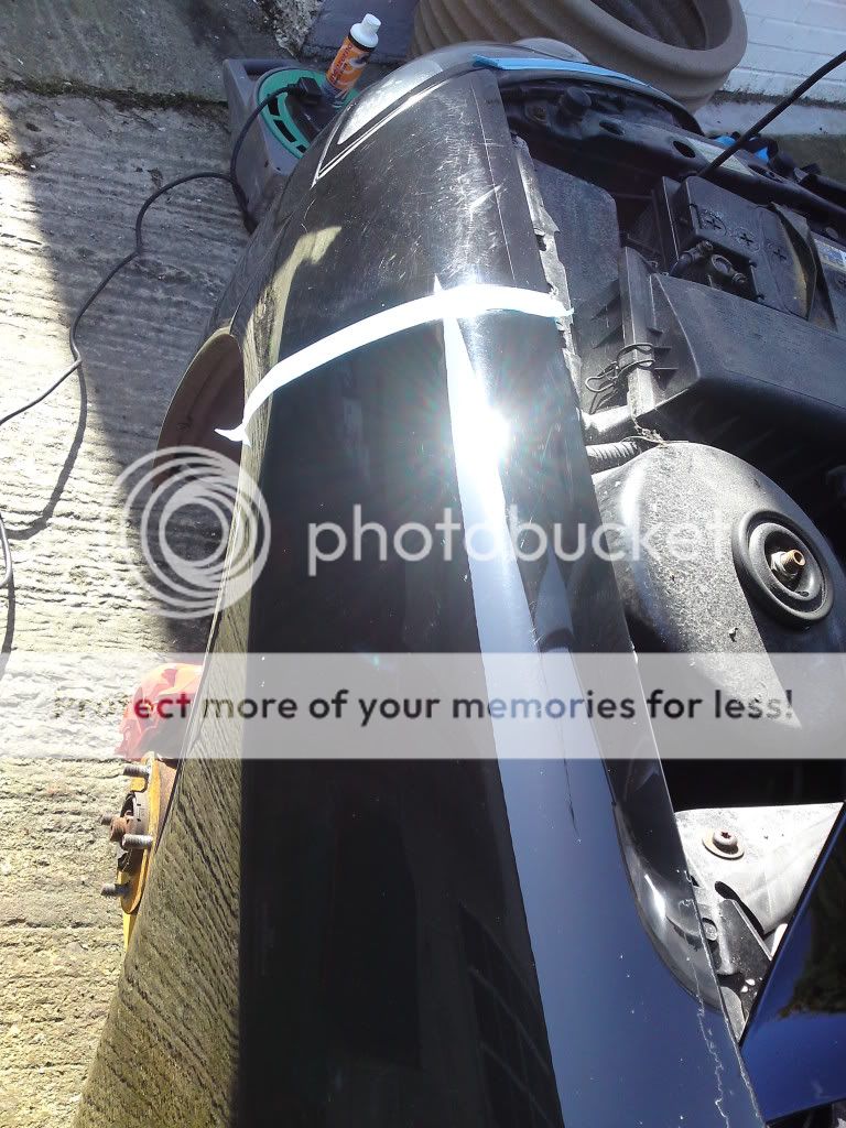

Anyhow, applying the same process as for the bonnet, this is a 50:50 shot with the right hand side after only 1 pass.
This is the wing after all the cutting, but before I applied the sealer and the wax:

Yes, the white dots are stone chips. I will tackle these after I have finished all the other more important jobs on the car.

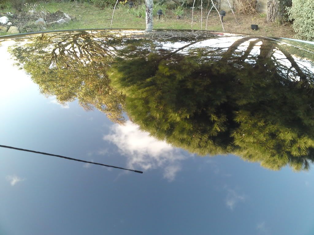

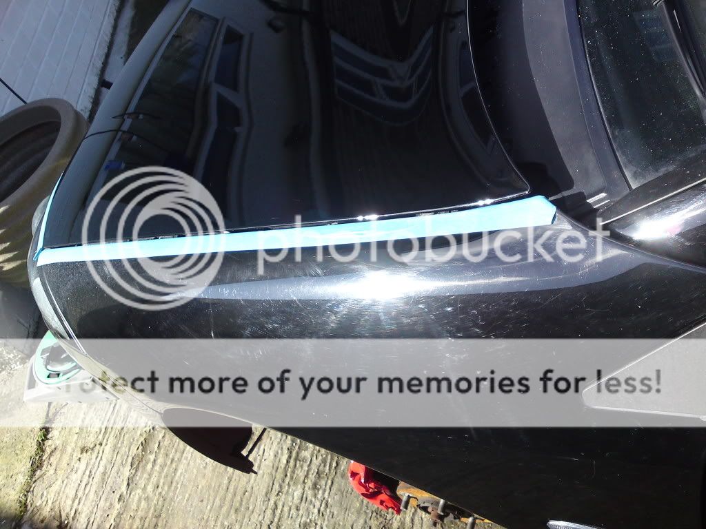

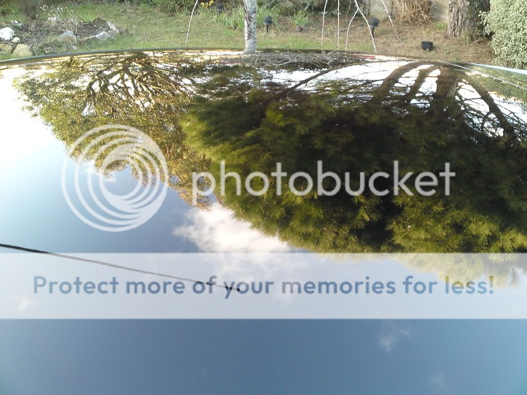

I then moved onto the roof, but because my phone was on charge, I don't have any "before" pictures. All I have is this one below, which was after all the same process as the bonnet, so after all the sealer and wax etc.
So, all in all quite a succesful day. Would have got more done if I had a roof over my head, but when the sun starts to go down, the air gets very damp which isn't good for this kind of thing.
