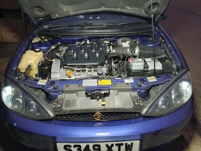

so today i decided to completely flush out the entire cooling system and heater matrix on suzi..
the old antifreeze had a strange smell to it and noticed lots of scale buildup in the tank so drained and flushed out then refilled with nice yellow prestone and softened water....
as usual ended up working in the dark....i hate winter:mad:
geez look at the state of that bumper..filthy bloody roads.
She looks good under there. I approve of ditching the cam covers breathing into the inlet and using mini breather filters instead.
Where did you get the plug leads ?
Reactions: shirtyzeus
there standard ford ones(leads)...just cleaned with wd40..
both the breather hoses had split and i found out that the air actually goes into the cam covers ,down to the crankcase and then into the uim via the pcm valve so put them(filters) on instead of having pipes going into the air box hose etc...works well..
