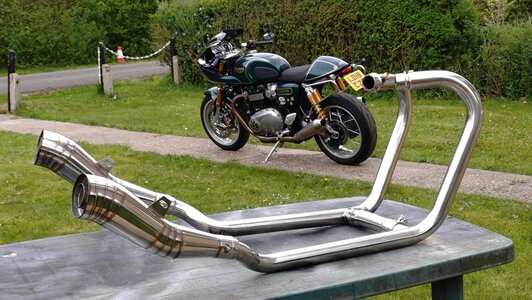

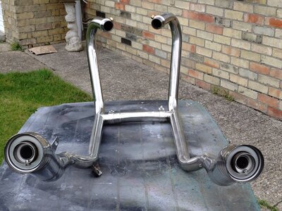

I don't know very much about bikes... What is that cross-piece between the pipes for? Is it something that multi-cylinder bike engines need or benefit from?
It’s common on twin cylinder bike engines. Usually referred to as the balance pipe.
Technically I don’t know any more about it’s function than the balance pipe name says.
It is hollow.

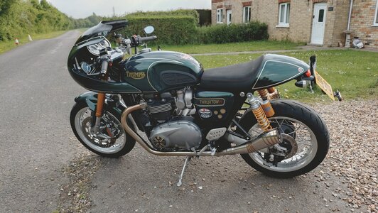

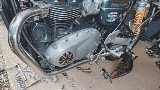

So after arguing with the entire bike to remove the oe header system (I kid you not, the bloody tank has to come off!!!) I managed to get the new headers fitted (even they weren't straight forward lol)

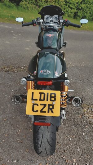

Also managed to cut all the surplus brackets off the new cans, and slotted the connecting flange so they could be clamped onto the headers, which means tomorrow............
.........I'll be making some new mount brackets using the time served CAD system lol
