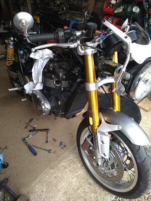

ok so it seems this bike has been crashed, altho i'm guessing it wasn't recorded, due to the fact it's been rebuilt by a spanner weilding monkey!!!!!

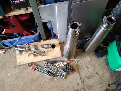

It's getting stripped of exhausts and wheels etc then rebuilt by me as i dont trust anything now, the top yoke was entirely loose, the fairing has been bodge repaired and painted (one side at least lol the other side they didnt bother!)
The exhaust has been assembled by a blind person with one arm lol clamps not lined up, or tightened up, and frankly i've not even started on the important bits yet!

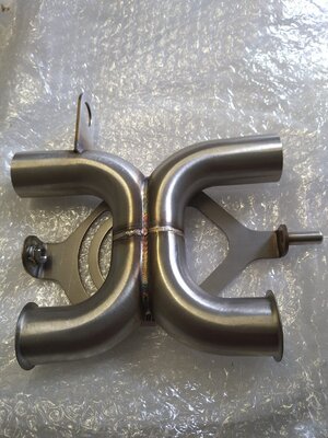

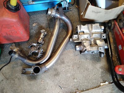

Well i'm this deep into it now lol cat has been removed and an X pipe (you wouldnt believe me if i told you 🤣) is on its way to delete it. Trying to find another fairing but 🤞 on that one for friday. Front brakes have been cleaned and serviced so all the pipes and brackets will be cleaned and polished before reassembly. Gonna take a while......

Right so now you're thinking wtf lol the exhaust is diverted into the cat box under the front of the motor, and is then diverted back out into the silencer, the missing bit is hidden by a very well disguised trim panel which looks like the exhaust pipe. The cat can be deleted, using an X pipe, and the ECU can be forced to re learn itself once it's been installed.

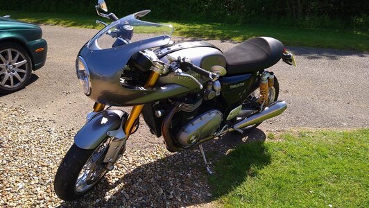

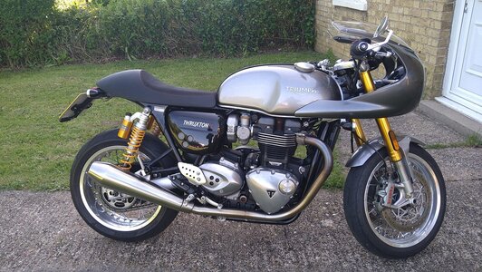

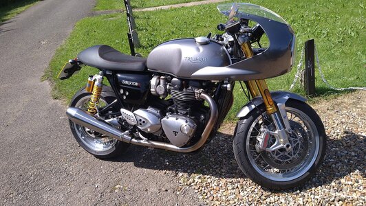

Got most of the Thruxton back together last night, even managed to bump start it in 2nd (bloody stupid ecu controlled starters lol, battery was just borderline!!) Gave it a little run up the field, and god this thing pulls like a flippin freight train! Lol hopefully get the fairing fitted tomorrow so i can get it out for a proper ride, altho i still have a few things to check :cool:
Reactions: backseateducation
Checks were carried out, suspension set up and fairing fitted :cool:
So it was taxed online for 6 months and then road tested, and oh boy was it ever road tested 😁😁😁😁😁😁
What a machine lol very neutral on the handling, bit twitchy on the throttle thanks to fly by wire, and the brakes!!! OMG the brakes lol Brembo M50 monoblocs that stand this thing on its nose in a split second, and then theres the noise..................... I mean after fitting this little thing (Black Widow X pipe decat)
Had a 90 mile test ride today, and wow, so glad i bought this :cool::cool::cool:👌
Altho i got to admit, I was a tad worried for a bit lol
