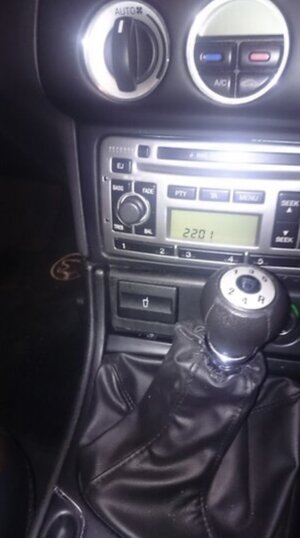

one last question , the gear knob is tatty....... I have had a google, but no luck . Any ideas where i can get a replacement from ? and are the number plates standard , or a bespoke size?
If you're good at DIY I bought this and it came up great for me
It's the leather cover so you have to cut your old one off and glue this one in

Also worth knowing that any lift-reverse Jaguar one from the days of Ford's ownership (like the X-Type) will fit as well. Just gives you more options if that's what you're looking for.
Also, my C2 leather knob (that I had for over a decade) wore out in the end and I replaced it with a late-model Transit one that's the same shape. It's plastic so not as comfortable, but is a straight fit.
Lastly - and I don't advise this - you can remove the reverse-inhibit detente from the bottom of the gearshifter (look under the gaiter - it's a little grey ramp) and then fit whatever the heck you want. Just don't go looking for a 6th gear that you don't have because the results will be more tragic than funny.

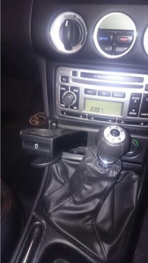

Hi Quicksilver, can you confirm a detail for me.
In reference to your photo…..
on the head unit, bottom RHS. That rocker button labelled “1” and “2”
The button beneath the rocker. Does it dispense chilled Coca-Cola with ice?
